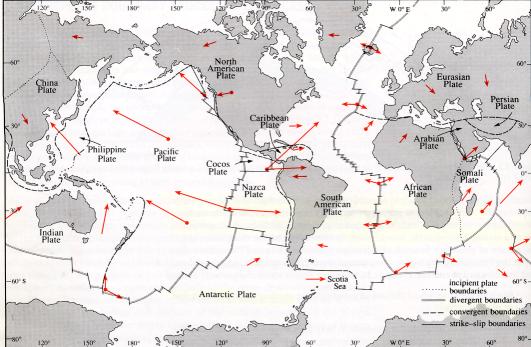

Colin (or anybody else who might know),
Most geological activity happens at the borders between plates. However, I've noticed that there seems to be something going on in the center of plates. For exampmle, Hawaii is in the middle of the Pacific plate and it quite active. The New Madrid fault in the center of the North American plate can generate magnatude 8 earth quakes.
Is this just a coincidence at these two places or is there some geological effect that occurs in the middle of plates.

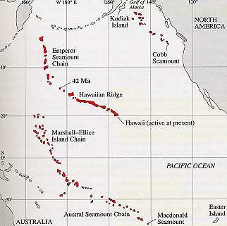

The Hawwiian Island chain seems to be te result of a 'hot spot': a local upwelling of magma that has remained in the same place as the plates have moved over it. The islands are all in a line, with the oldest at one end and the youngest, and most geologically active, at the other.

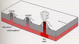

Well Mike asked so I better answer although Alan's just about there with his answer.
The Earth's tectonic plates are all in motion at varying speeds and in different directions driven by convection currents in the mantle underlying them and by the gravitational pull of the plates at subduction zones.
Most volcanism and seismic activity takes place at the margins of these plates. However there are points dotted all over the earth where hot magma rises from deeper within the mantle (through processes that would take too long to explain) in the centre of plates, and as Alan correctly said, are called, not overly imaginatively, "Hot Spots". One such hot spot underlies the Hawaii. As the plate moves over the static hot spot one volcano, becomes extinct and a new one is formed.
The resulting chain of extinct and active volcanoes is useful in determining speed and direction of plate motion. and the Hawaiian chain shows that the pacific plate has changed direction.
